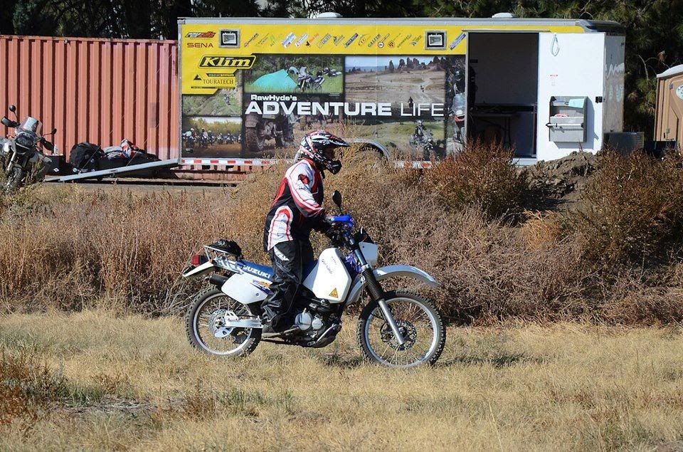

Friend just sent me this pick from the Rider Clinic. 1996 Suzi DR350SE
