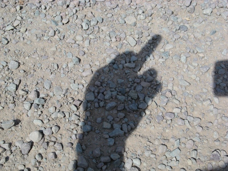

Let's set some parameters to operate in first: I am not an expert on or off road rider, but I recently had a bit of experience trying to sort out myself and my bike for loose gravel riding. Secondly, choosing new tires because you had one negative experience (?) will cost you a lot of $$$ in the long run.
Let me explain and I hope some of the other riders chime in too, because this subject is right up there with "what oil is best." But I believe there are at least two components to dirt riding that can help save you from a faceplant and almost certainly, improve your riding experiences.
You would think my mighty XRR, or anyones KLR, EXC, BMW, Adventure etc would be great on something like this.... Wouldn't you?
Well lemme tell ya, in this picture my bike has 30psi in the tires for street duty. The fact of the matter is going in a straight line down this road with that much pressure in the tires can be quite unnerving. Why? Because the bike is constantly squirreling around under me, a lot.
Which brings me to the first and most profound gravel riding tip, lowering the air pressure in your tires! Lowering the air pressure to the same as dirt riding will allow your tires to conform to the road bed a little better, provide a better contact patch to the graveled surface and should give a better "planted" feeling.
Tire pressure alone will not solve getting squirrelly on gravel and you should not think street skills will keep your wheels under you. HOWEVER, with that said you can save yourself some money by messing with tire pressure first. It sucks for us dual-sports because if you are 50/50 then you could potentially be taking out and putting air pressure back in depending on how often you feel the need. Keep in mind low air pressures meant for dirt/gravel can be dangerous for a heavy bike on the road. Thus my reluctance to say specifically how much air to try.
I have ran my Pirrelli MT21's (DOT knobbies) at 28psi and scared the shit out of myself within 100 yds of a asphalt to gravel transition. Lowering my psi to 13-15 makes a HUGE difference in how MY motorcycle feels under me when I'm on gravel. And this leads me to the second thing I consider most important.

The other thing, as XCR mentioned, is experience (or practice makes perfect). I shit you not, I go out and find a section of gravel like the road I pictured above and will just go back and forth practicing to get a better bond between me and my bike. I do slaloms at low speed, stand, sit, braking. I'd say after the first five times of making myself practice what had previously unnerved me, I felt twice the confidence.
